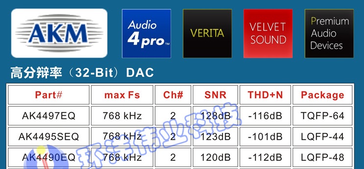

我看4495SEQ的官方资料很牛,7V 123db 这是要上天了,还能解码32bit音频,就是如果用7V电压,电池怕扛不住。
从参数来看4497EQ更牛,不过再牛调不出好声音也是白瞎~
1.    128x Over Sampling Stereo D/A Converter
2.    32-bit 8x Digital Filter (4 types of filter option)
3.    Sampling Rate: 30kHz~768kHz
4.    Low Distortion Full Differential Output
5.    SCF
6.    De-emphasis Filter
7.    Soft Mute
8.    DSD Input(2.8MHz, 5.6MHz)
9.    External Digital Filter Mode
10.  THD+N: -101dB
11.  DR, S/N: 123dB(7V)
12.  Power Supply: Analog: 4.75~7.2V, Digital: 2.7~3.6V
